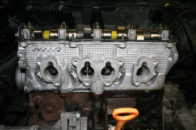

                      today nick came over and we torqued the head down, and installed the cam as well
                      mmmm head.
                      im excited, geoff did the head work for me, it was supposed to be for my mk2, but that never happened, i cant wait to drive it and see what it will be like, i know its nothing crazy like a turbo or anything, but this is my first motor ive ever done any work to.
                      goal is to get it running and then look into a chip for it as well, and perhaps an adjustable timing gear, as i was told that might be needed to tune in the power whare i need it.
