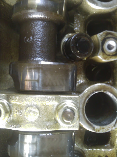

                      do these cams look OK? I had the valve cover off to replace the gasket...and i dont have enough experience to know if this wear is normal or not.
                      Doug
