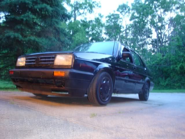

    and it's not really a project either, but since what I've been doing to it kinda qualifies it as a project I guess I'll post it here. :D:

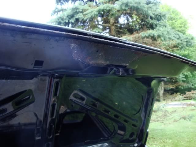

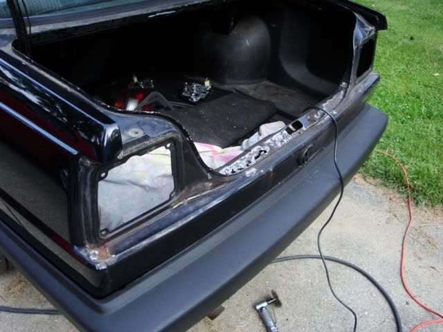

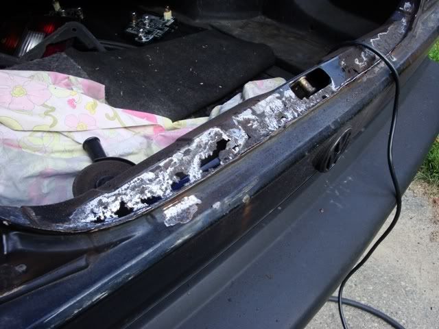

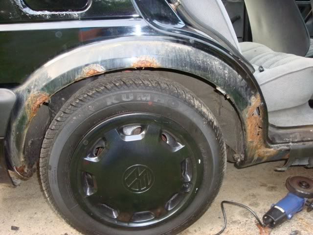

    Well it all started when I went to go look at both this and Chad's red 88 GTI. A week later after finding nothing else on the net that looked decent for less than 2k I ended up buying this. Got it home, next day started sanding at the bubbly spots, cut out rusty/thin metal. Day after that, cut new patches of sheet metal and welded them in (still can't weld, and my non-gas shielded MIG doesn't help that). Today, did some extremely quick bondo work that doesn't look good but better than weld beads...primered and painted, will be clearing later this week. I don't care too much how it looks, it's a driver and I will be driving the piss out of it!

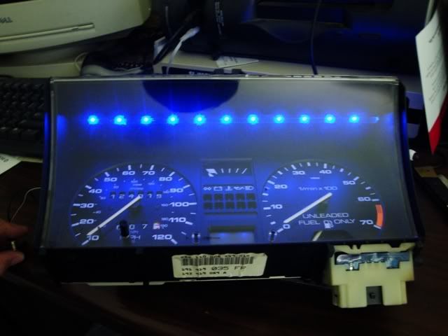

    Today I removed the instrument cluster and found out why the gauges didn't light up when I turned on the headlights-turns out that the bulbs in the top were burnt out. Instead of going on a massive search to find them I replaced them with an led strip that I purchased from Wal-mart, I ended up having to shave a little off of the cluster housing but it all fits in fine. Looks great, only complaint I have is that the connector for speedo cable is broken. Have JB weld on it curing now. Hopefully it will hold, when I took it apart at first it was held together with duct tape :ugh!:

      thats alot of cancer, i wish you luck in your playtime adventures. Whats the plan for use? daily driver?

        Yep, just a daily driver. It will endure all the rain/mud/salt and snow while my Formula sits nice and cozy in the garage. Likely the Jetta won't change much other than a plaid accented interior, stereo, and maybe wheels.
