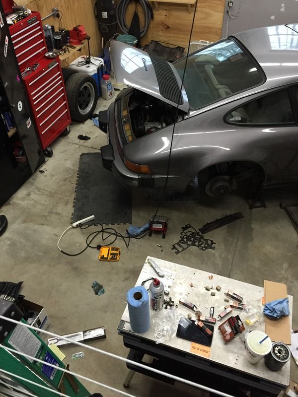

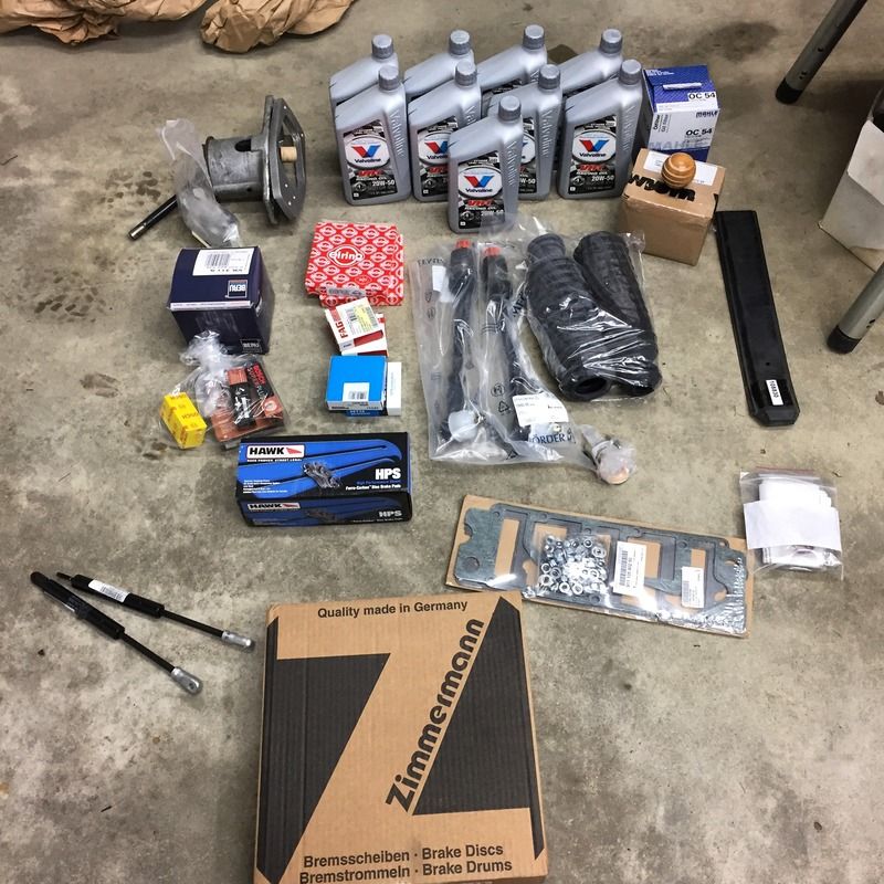

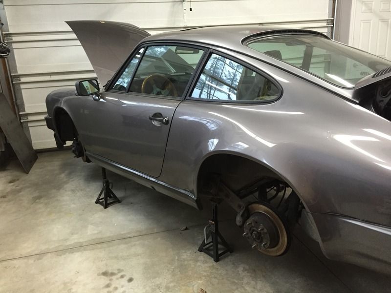

                        In the midst of getting this thing put back together but here are a couple pics of the parts and process. I haven't forgotten just no time to update! lol
                        Hopefully wrapping things up this weekend to get alignment and inspections done before May 8/9.
